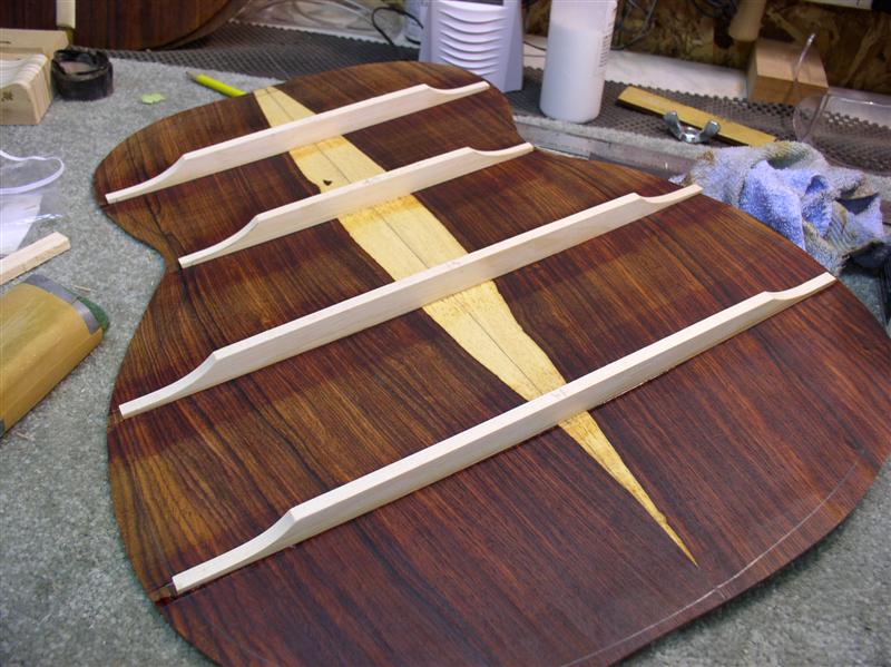

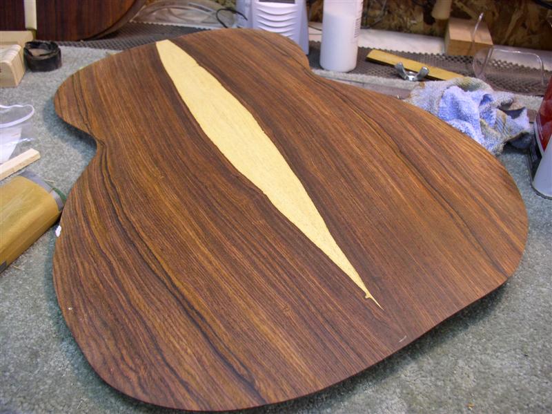

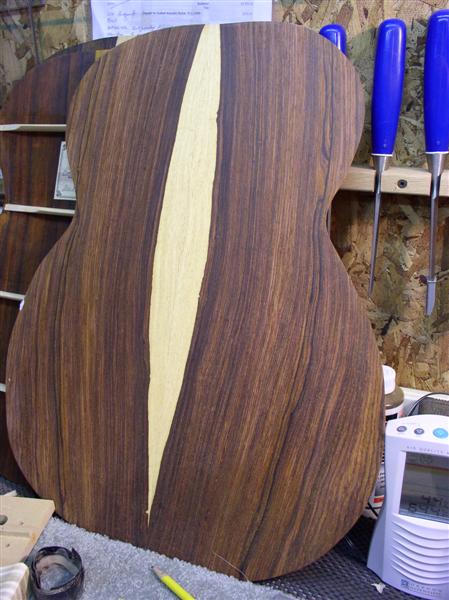

New back with sapwood

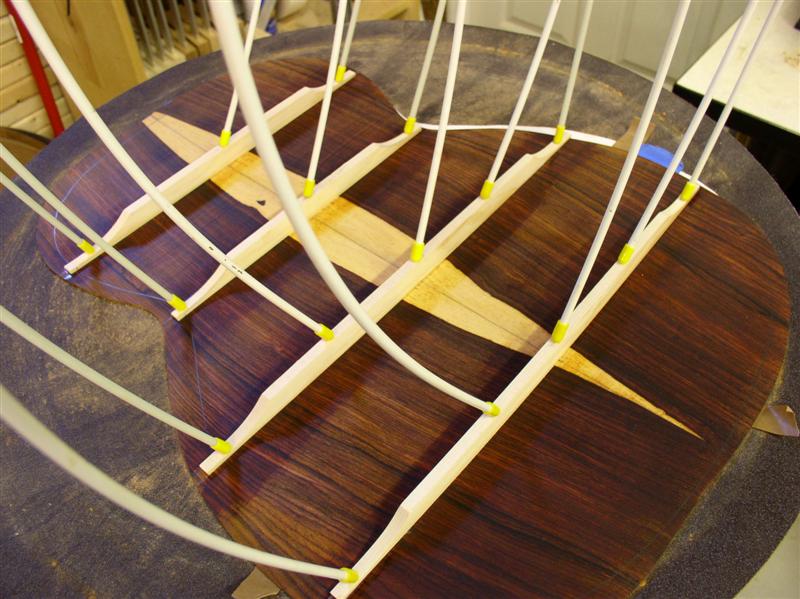

Braces glued on with epoxy,

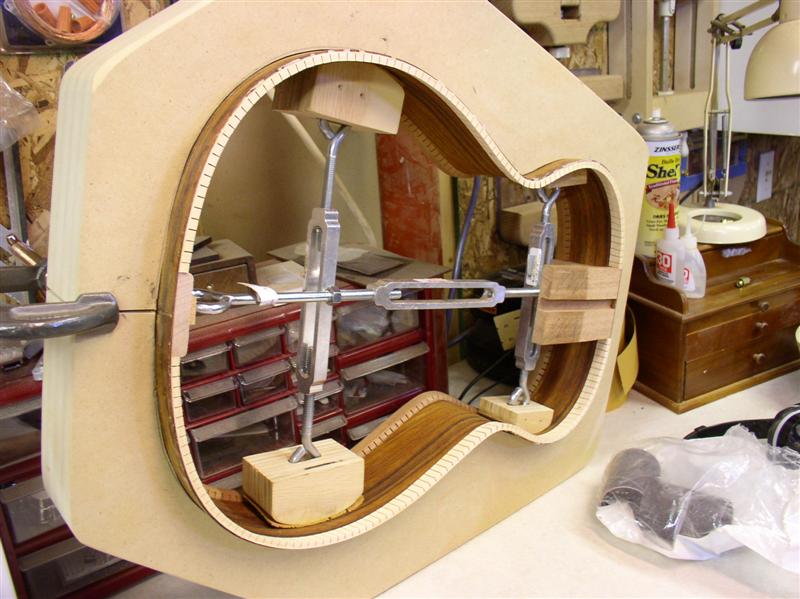

New OMFS mold with new side set.

Lance, I really like your set up! I’m gonna have to get, or make a mold one of these days.
That coco back looks outstanding, and I love the sapwood center strip!
Curious though, why reverse kerfing on one edge but, not the other?
Also, I’ve not seen braces shaped like that before, could be just me, seeing something in the
pictures not exactly right, but, they do look a little beefy. I’m sure you planned it that way for a
reason. Just wondering!
Robert
PostPosted: Tue Apr 17, 2007 5:14 am
Robert,
the braces are beefy right now, I glue them on full width and profile them after there dry, but before I put the center strip in.

Lance, Looks good but that wide sapwood,I don't care for myself.I don't mind a small strip in the center but this is too much IMHO. Good luck with the rest of this build,I hope it goes smoothly for you.
PostPosted: Tue Apr 17, 2007 11:51 am
Dave, I totaly know where your coming from, but for me, the more the merrier!

PostPosted: Tue Apr 17, 2007 12:29 pm
Posts: 2692
I would be nervous about that sapwood. Seen it check too many times.

PostPosted: Tue Apr 17, 2007 12:50 pm
